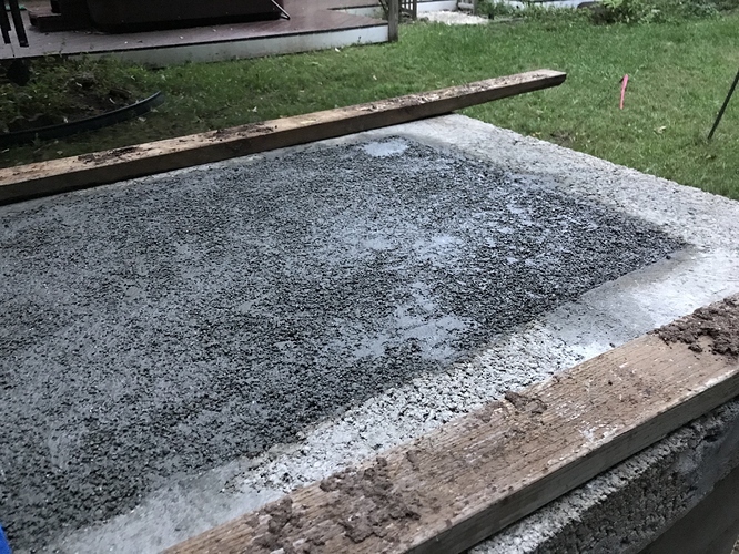

I used my material transfer shovel to transfer the mix to the slab. I spread it out to the edges, then used my tamper to compact it. Then, I repeated.
It took 3½ loads to fill the void, with just a little left on the slab when I had screeded for the last time. I troweled it smooth, then decided to float it as well.
