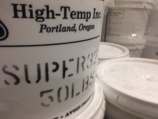

Can I use Pre-Mixed High-Temp Mortar on a Mattone Barile Grande fire brick pizza oven kit?
I see the note to “NEVER USE A HIGH-TEMP MORTAR FROM A PAIL OR BUCKET!”. What is the reason for this. My local store (High Temp Inc. in Portland, OR) sells a pre-mixed mortar that I’d like to use. Any reason this wouldn’t work?

@BrickWood is very specific on this subject. He says that liquid-form mortar will remain soft in this application, and that you must not use it.
However, I followed the link you provided and read the description on their Web site. While I believe them when they say it “works flawlessly as a fire brick mortar in kilns, forges and even pizza ovens,” I don’t see a data sheet or detailed specifications for it, just that it’s rated up to 3,200°F.
I’m going to hang out the “wiser heads needed” signal and ask @BrickWood to weigh in on this. I know that both the convenience and the cost look tempting, but I’d wait for his opinion on it—because I’ll trade both convenience AND cost for an oven that works.
