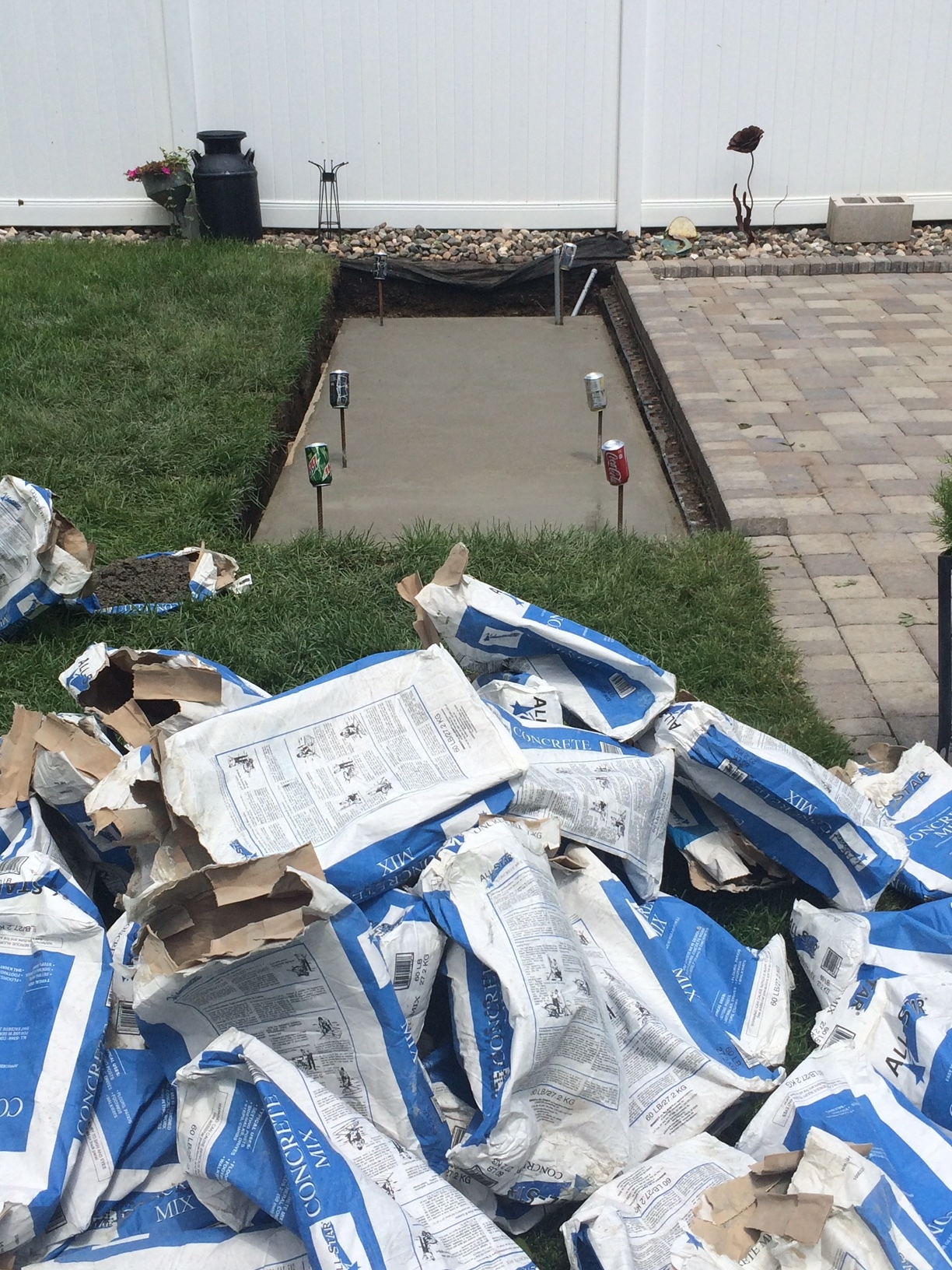

I poured a 6" thick slab below the depth of my patio and once the concrete blocks were set for the base I leveled above the slab with gravel and sand and ran patio blocks up to the oven base to extend my existing patio around the oven. Cutting patio blocks is good practice for when you have to cut the oven brick.
