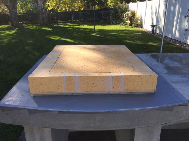

Hi All,
Can someone confirm the recommended size of the “Insulation layer” and Firebrick layout? I am pouring a “monolith”? slab, and might end up with an odd shape. Due to depth, I will probably end up with a setup like the enclosed picture.
Sincerely,
Dwayne

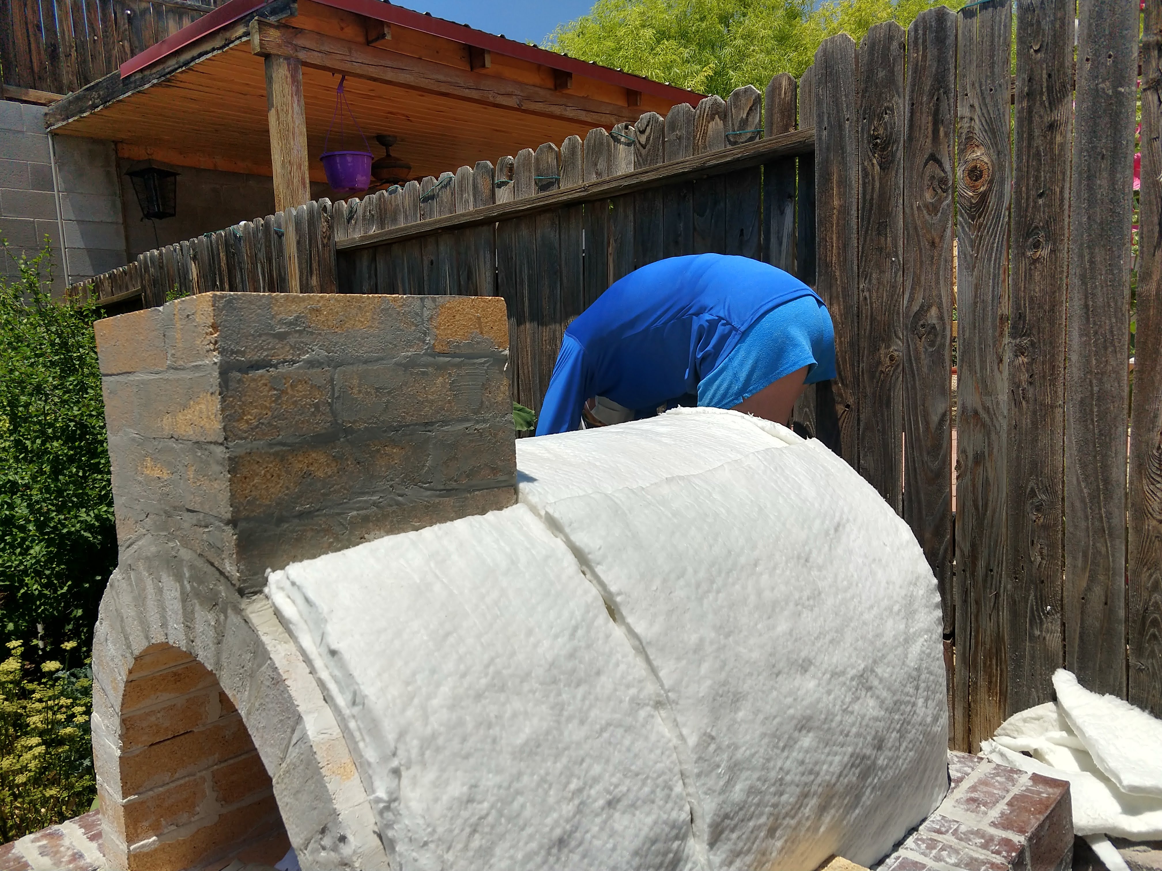

I covered mine, partly because I didn’t really want the red-brick look, also because my hearth brick work was a bit messy with the mortar. That’s what happens when you lay brick for the first time in your life, and its 100 degrees outside…things dry fast! Happily I can report no cracking of the black granite tiles I used, even though the sun keeps em’ at about 700 degrees lolz!
Hi Dwayne,
If I’m understanding your question correctly. Your firebrick, blanket and stucco is roughly 7 1/2 inches on each side.
Firebrick- 4.5 inches
Insulation- 2 inches (double layer as directed in instructions)
Stucco- 1 inch.
Hope I answered your question.
Hi 423 Tommy and Carlos! Sorry, I should have been more specific. I looking for the Width and length. The directions show (on page 5) 36" x 40.5". but I wanted to confirm.
Dwayne
I honestly didn’t even measure, due to ordering the foam form. I just layed the bricks on/behind it so it auto-measured for me the main brick tunnel/arch. Then I just kinda winged it, I used 2" of insulation on front, but 3’ on back to give it a “fatter” look in the rear (I know that sounds weird
). Then I put two layers of mortar and 3 of stucco so it’s really fat. I figured as long as the inside is right who cares how thick the outer layer is…at least that was my reasoning.
Ah I understand now. My instructions that I have say outside dimensions our 48 inches front to back and 40 inches side to side. These are from page 5. Now thats just the oven not the red clay bricks. Granted my instructions are from about 5 years ago. So I don’t know if they made a change. Unfortunately my oven now has a brick enclosure around it and I can not measure it. If my memory serves me it was close to the 40x48 dimension.
My advice is to give yourself some wiggle room. Or do what I did and make the top slab big enough to rest a glass of wine or any beverage to keep you and your guest hydrated while cooking your pizzas.
Carlos…got it. I think that’s my plan as well!
Dwayne
Thanks 423tommy. I think that’s the plan!
Dwayne
