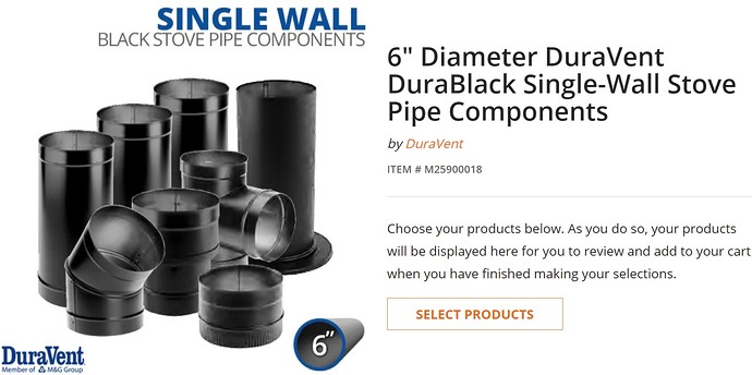

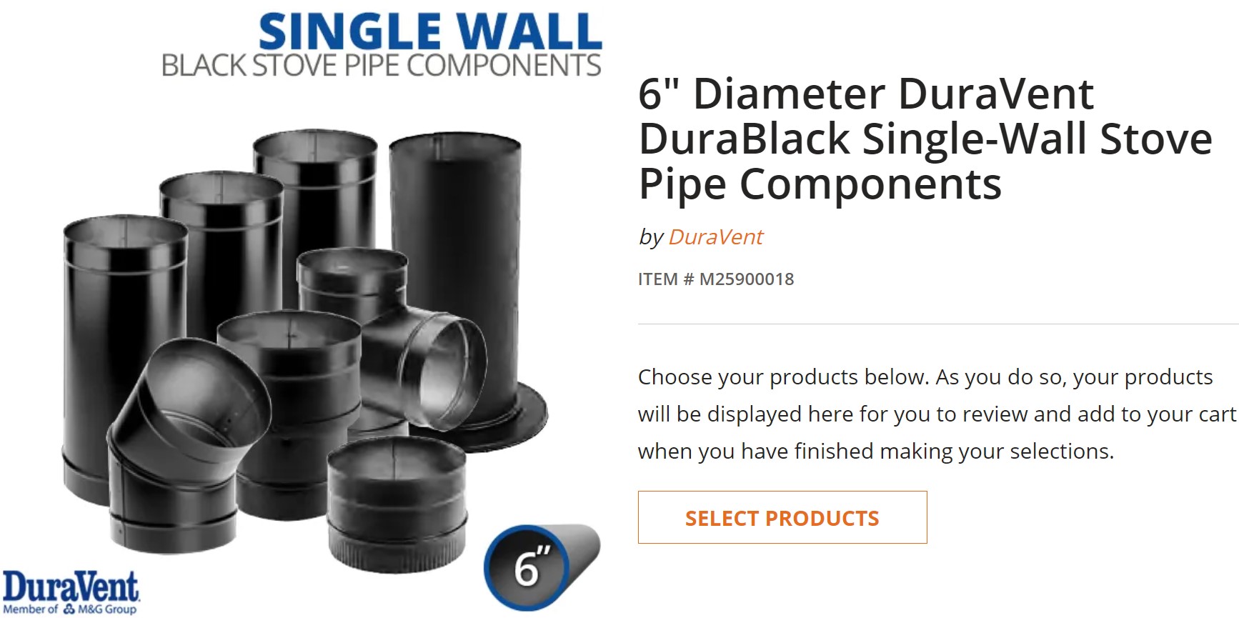

We recommend and sell double-wall, Stainless Steel DuraTech exhaust systems that are made by DuraVent in Vacaville, CA. They are higher quality and cost a few dollars more… But if you are running a long pipe / vent as you posted, you might want to take it down a notch.
DuraVent makes a line of painted, single-wall exhaust systems under the DuraBlack nameplate. Now, I’ve never used or installed a DuraBlack system, so I honestly can not attest to the durability of the product when used in a high temperature pizza oven. But our competitors have no problem using them…
  • Damper Pipe
  • Single Wall
  • Inexpensive
