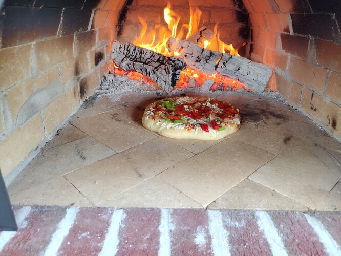

Good news: I cooked my first pizza (practiced with a DiGorno).
Bad news:

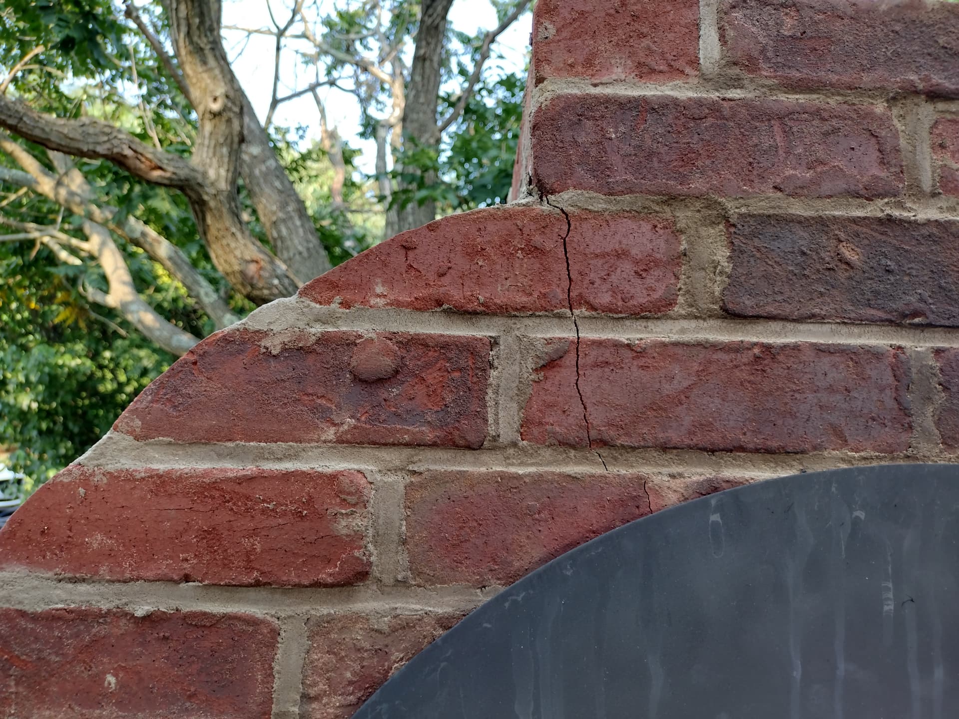

I think I had the fire too close to the front, it cracked the veneer. :disappointed: I strictly followed the curing fires. I guess half inch veneer is too thin for the front of the oven.
