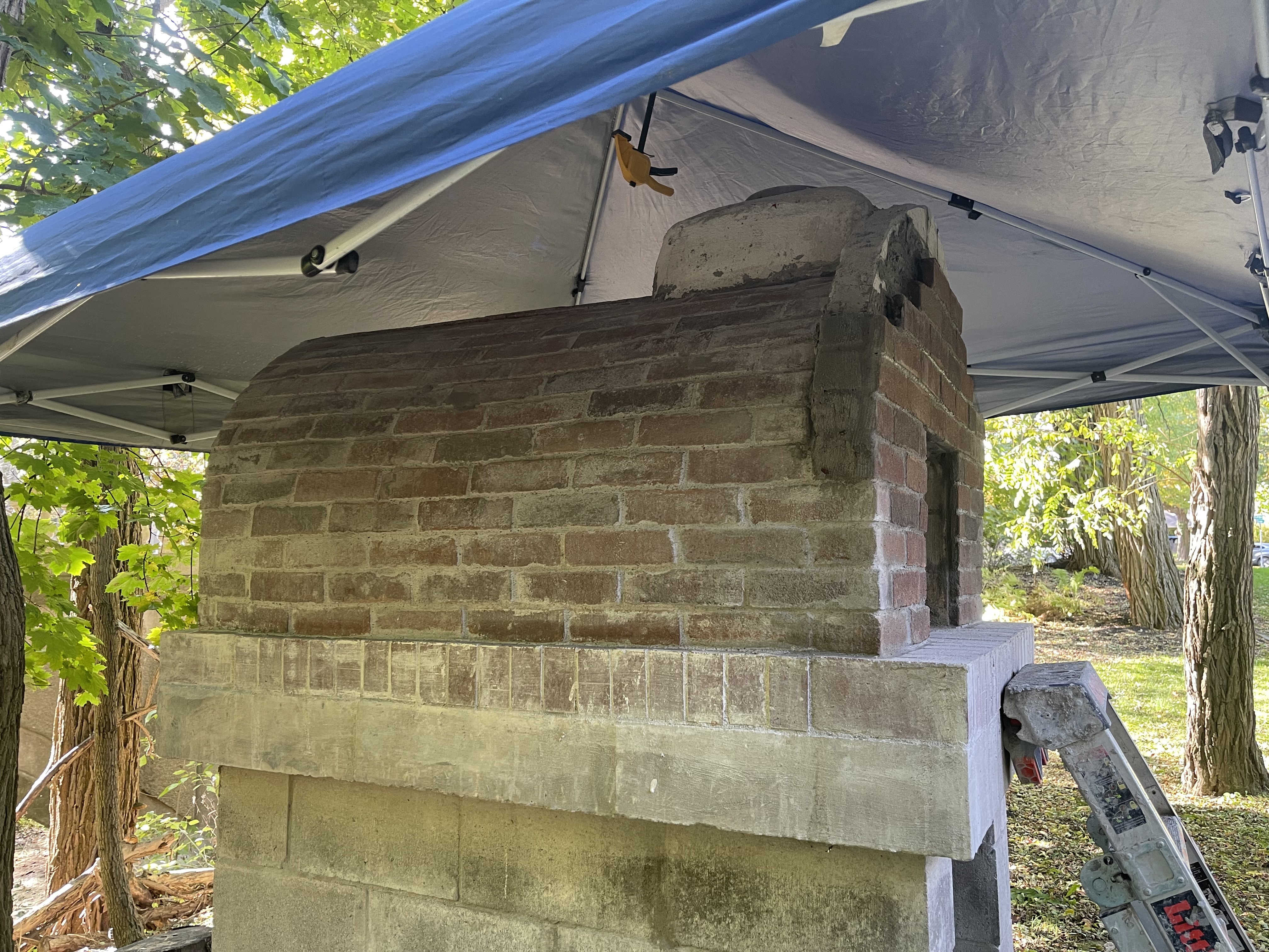

I’m almost done with the brick veneer.!!
I love how it looks.
I need some help/guidance.
The instructions state to allow 3-4 days for the veneer to “set.”
1.) Do I have to wait 3-4 days before applying the waterproofer? Or does that 3-4 days apply to the initial firing over the 5 days?
Put another way…what is the timing?
2.) After I finish the veneer, how long do I have to wait before applying the waterproofer?
3.) How many coats of waterproofer? Time between coats? Any tips?
4.) After the waterproofer is complete, how long do I have to wait before beginning the firing?
Anyone having any recommendations?

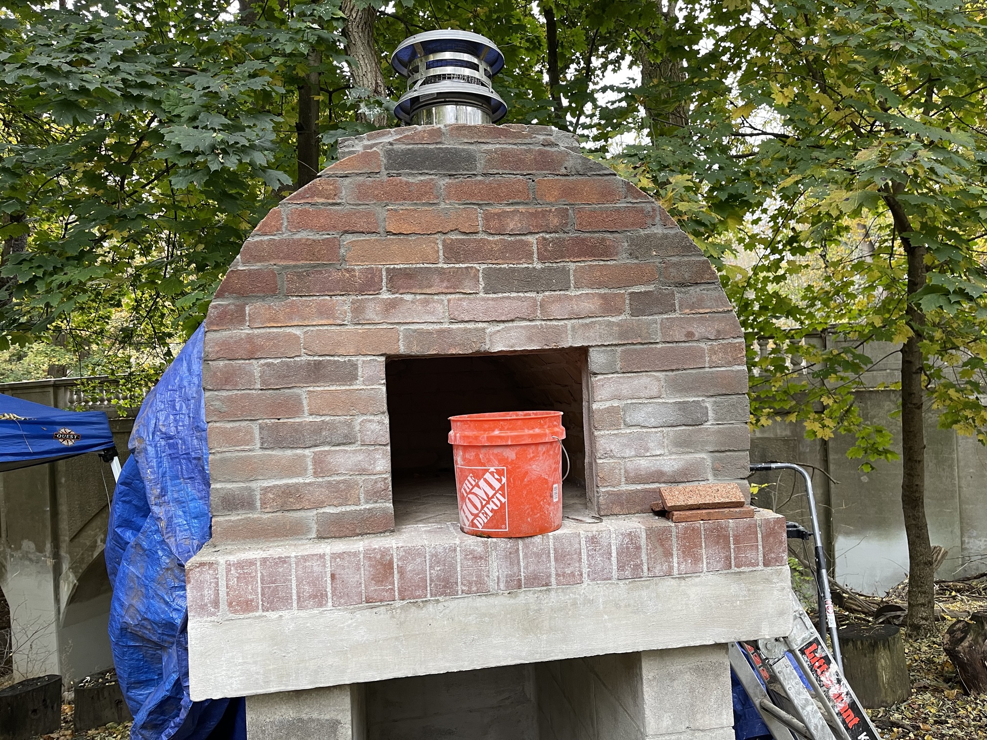

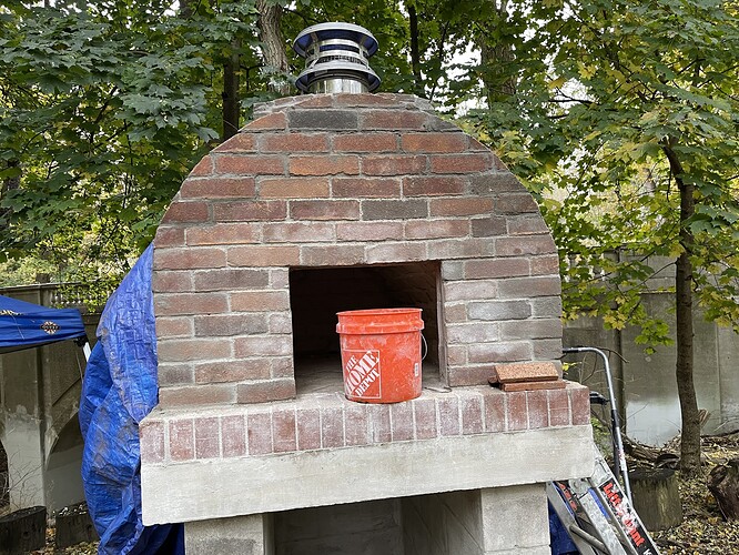

Thanks Matt!
I have a few very small gaps to fill in with mortar. Maybe 1/4 cup in total. Probably less. Hoping to make those cosmetic updates tomorrow.
Given the small nature of those…I’m planning to waterproof tomorrow as well. Please let me know if this is a really bad idea.
Beginning fires on Sunday.
You should be fine. With smaller areas water will migrate along the interior mortar lines and find its way out as vapor, most likely at sharp corners and edges.
And tomorrow is the Big Day to start. I know at this point you are trusting the advice in the instructions, so this is more a general reminder for other builders: follow the curing fire instructions to the letter, even though the first couple of fires will seem pointless. Low and Slow are your watchwords. Soon enough you will be touching 1,000°F…well, not literally touching…and all this hard work will pay off.
Looking forward to seeing your finished oven!
