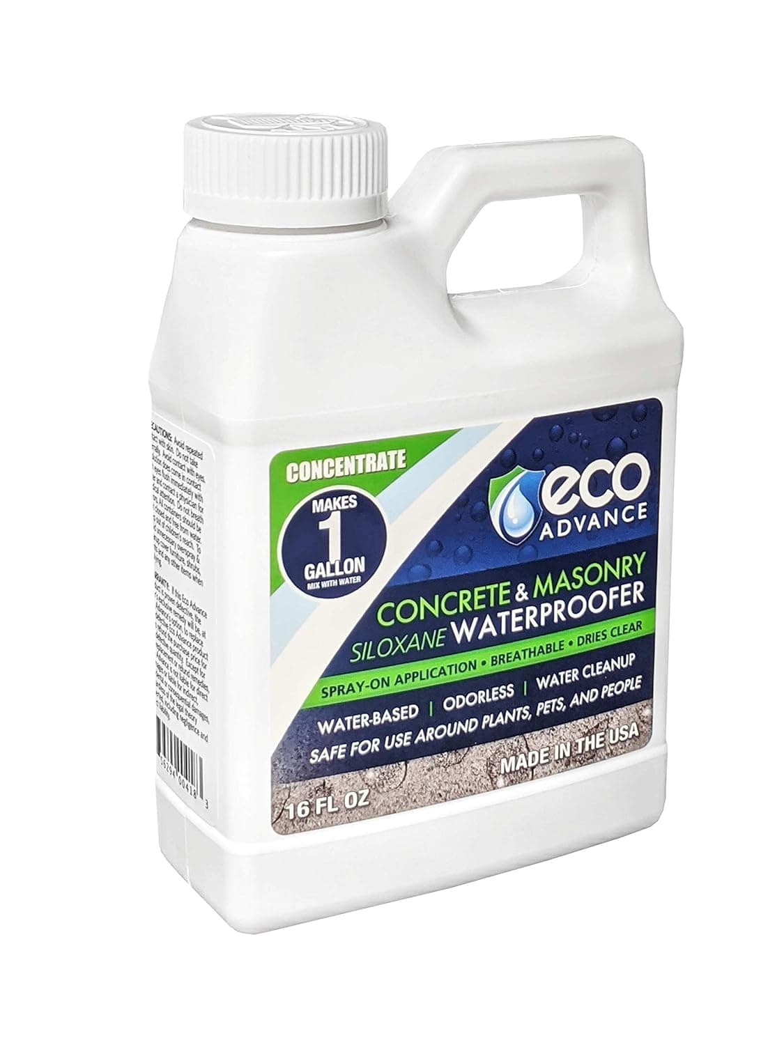

Also - Be sure to seal the oven & base every year with an NON-TOXIC MASONRY SEALER like:
