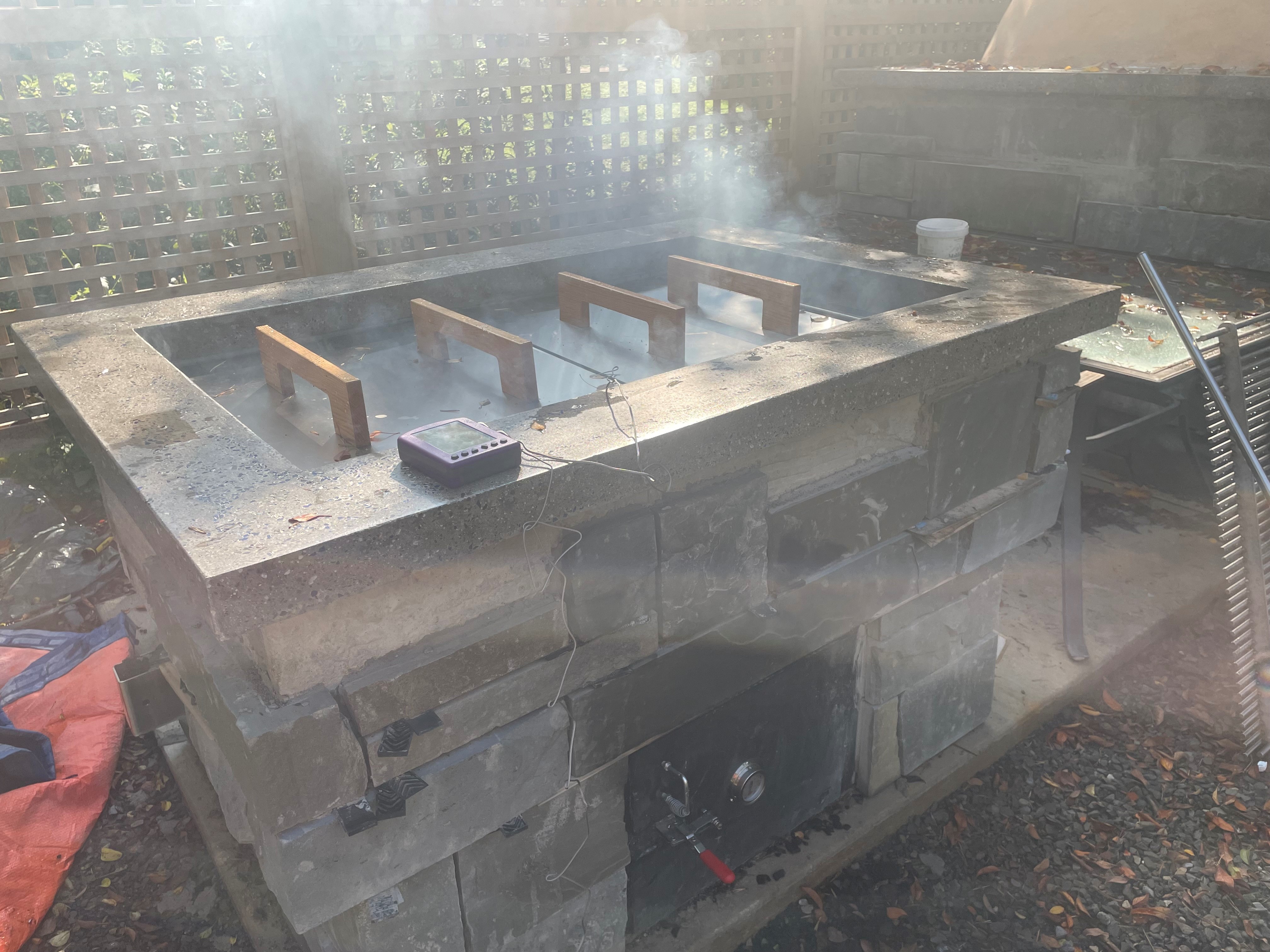

Just finished my box. So far smoked a brisket and blue fish and used as a grill. I love it! But use pizza oven for pizzas if you are lucky enough to be able to have both.

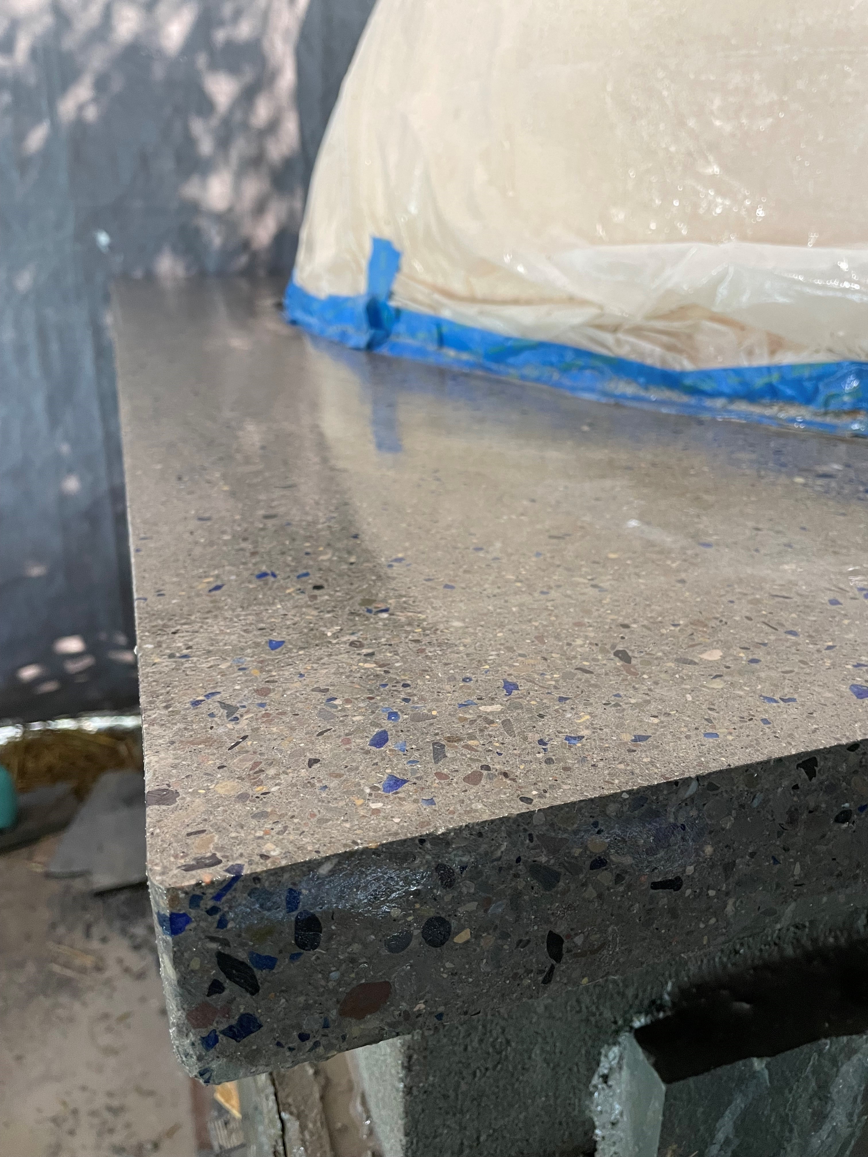

Thank you for the reply. I noticed you made a concrete (or granite?) top for the Grill. Can you post a little bit about it? probably not in Pizzas, but somewhere in the BrickBox. I think I like it and it seems better and smoother than the veneer. I have placed Chicago bricks on the bottom (cut in half) and plan on putting Chicago brick veneer on top. A colored concrete border might be nice.
It is concrete. I added some glbutt and polished it. One I poured in place and one in a mold. I have been planning to post all the pics from my build soon and haven’t done it yet (as you can see I am a few stones short of being finished with the veneer, but since its fully operational I have been distracted by cooking and eating!).
HAHA… I have not taken out the grills to avoid that. I am finishing the veneer on top (I did the bottom first). I will probably do it this weekend, or most of it, but I think you had a nice idea. I would think you pour everything in place.

I poured the one around the pizza oven in place (because its rounded) and made the box one in a form- mostly to experiment with the two methods because I had never done it before. They both came out essentially the same (I think I did a better job distributing the glass on the poured in place one because its slightly easier to see what you are doing). If you pour in place the lesson I learned is to polish it before you put the veneer on or else wrap it well, because the ground concrete wants to run all over your finish work…
