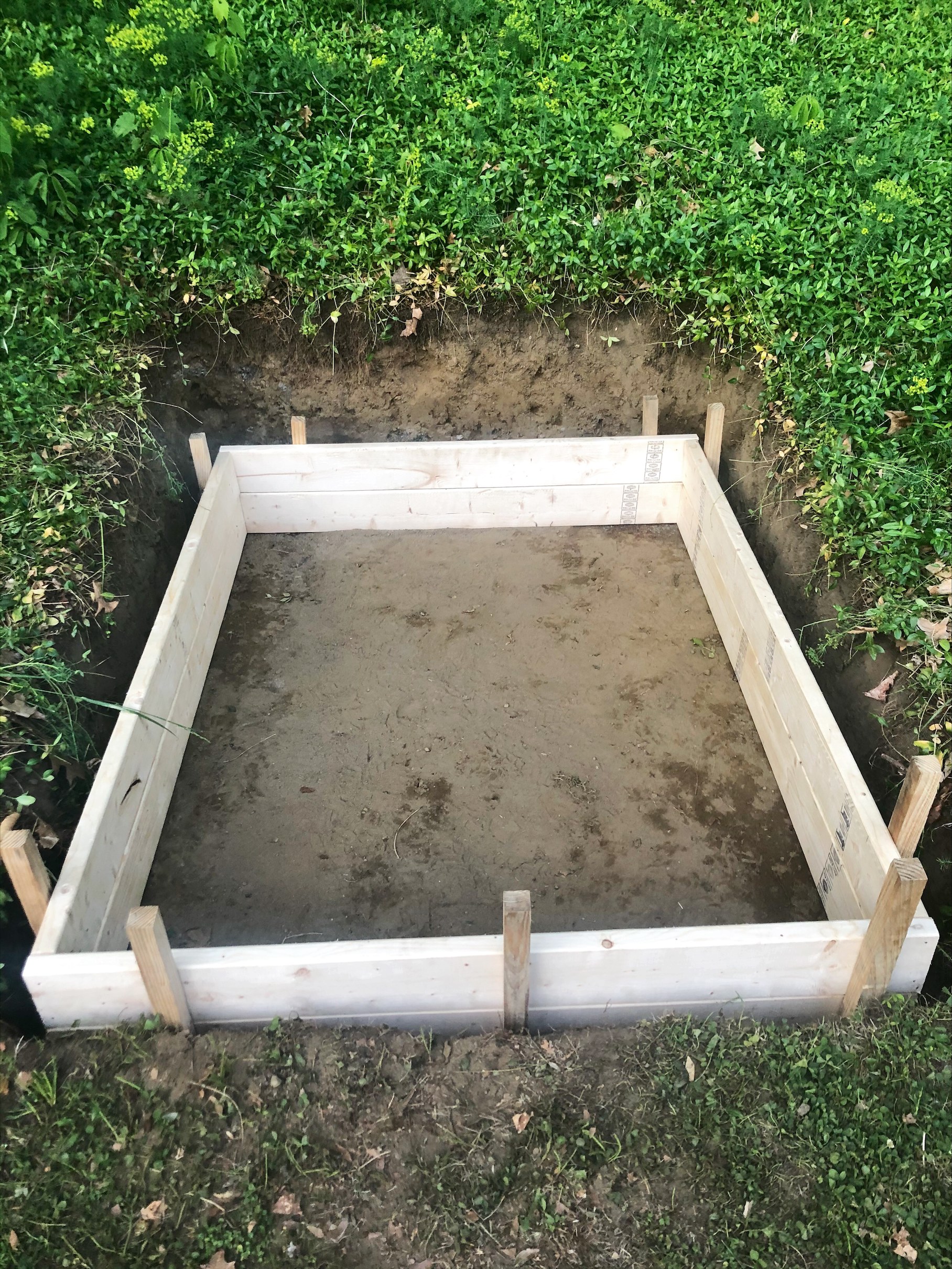

I am in Vermont so I went with a frost protected floating slab for the base. Up top, I went with a poured in place hearth slab because I was going to have a hard time finding people to help me lift the three slab sections into place.

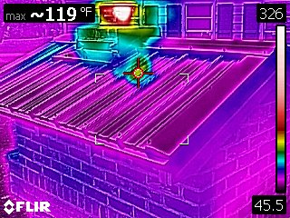

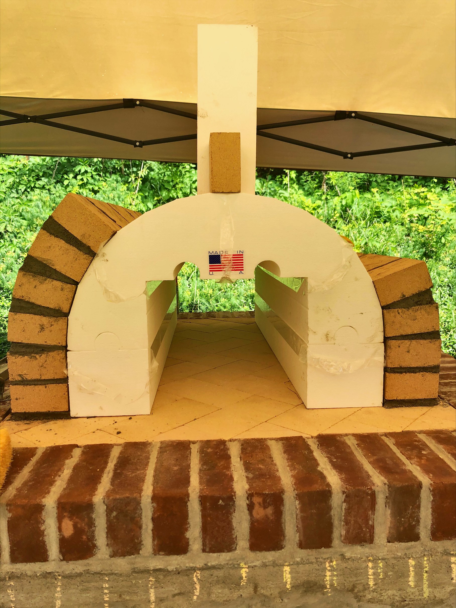

The width of the hearth slab had to be increased by 4 inches to account the added dome insulation that is recommended for cold climates (I included some thermal images to show the great job that the insulation does). I also increased the length of the hearth slab by a couple inches to make sure that there was room for the brick exterior enclosure that I went with and the 6 inch lip that is needed for the door.

FLIR0037 FLIR0039

The infrared photos show exactly what we’d expect about heat loss—chimney and door, and everywhere else is cool as a cucumber.

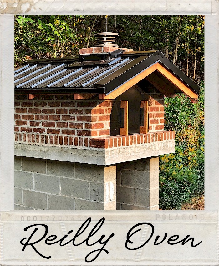

BEAUTIFUL oven! And w/ 4 layers of ceramic fiber blanket… you’ll be able to bake during a snowstorm! And I love the gabled roof! Someday… we’ll make a set of directions on how to build an oven as you did (but for now, we’re just going to send inquiries about enclosed brick ovens & and brick ovens w/ gabled roofs directly to this forum page (as you did a FANTASTIC job).
It’s amazing to see the heat retention and areas of heat loss in the Predatorvison pics! Speaking of pics… here’s your “Polaroid” Photo Gallery image. We’re hoping to have the new website (and your pics) posted by mid-Feb.
