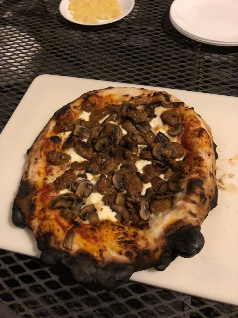

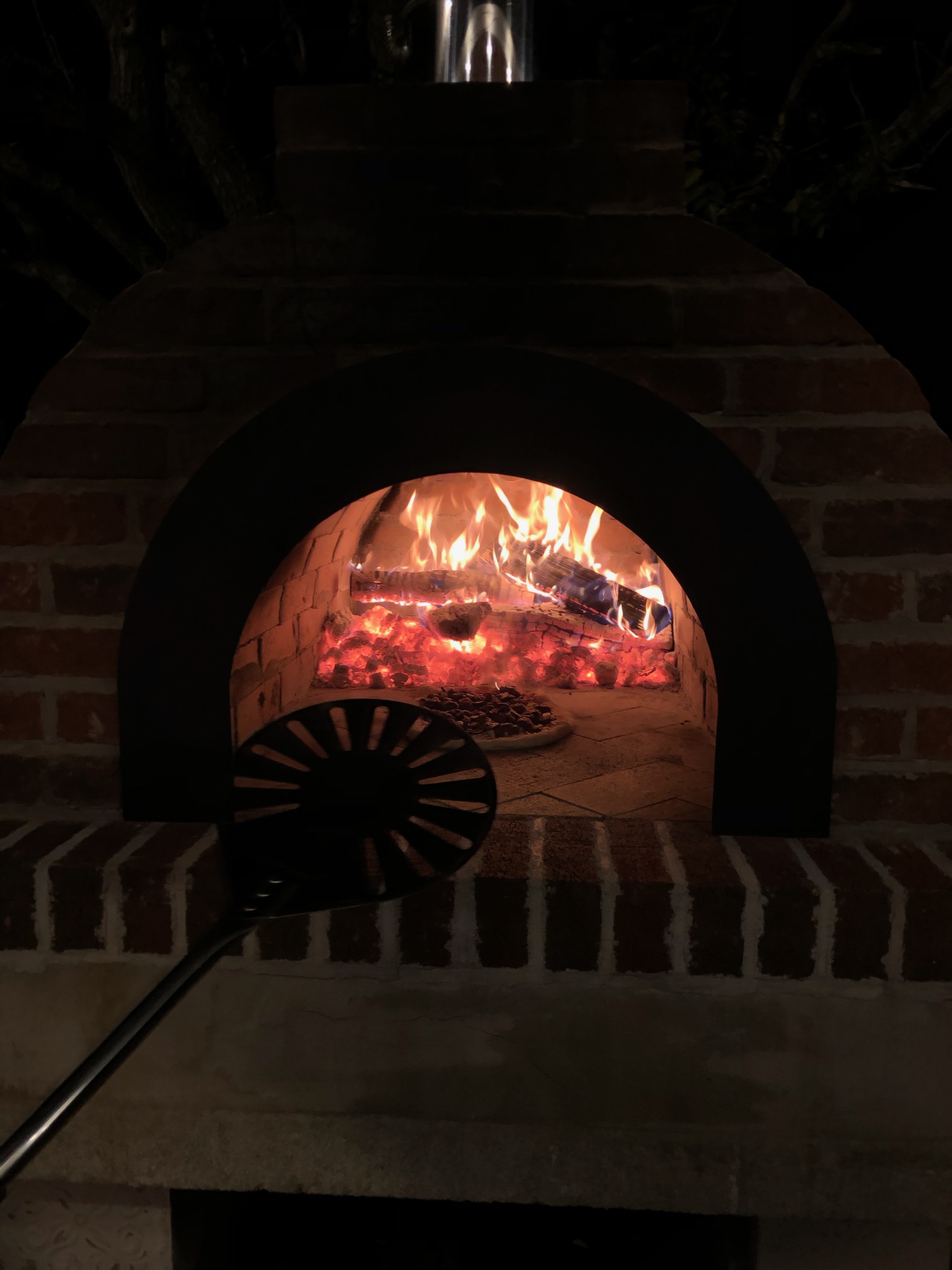

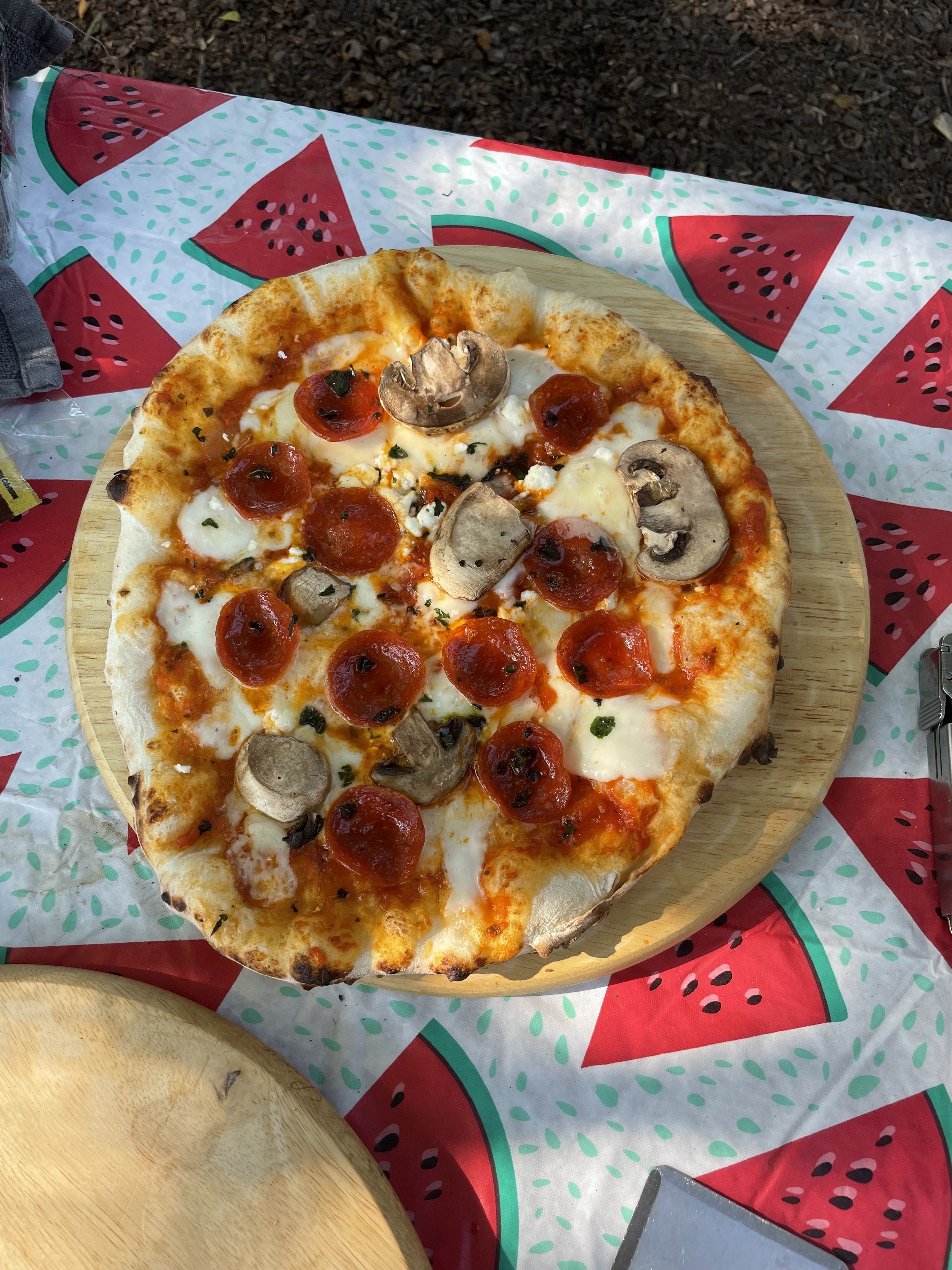

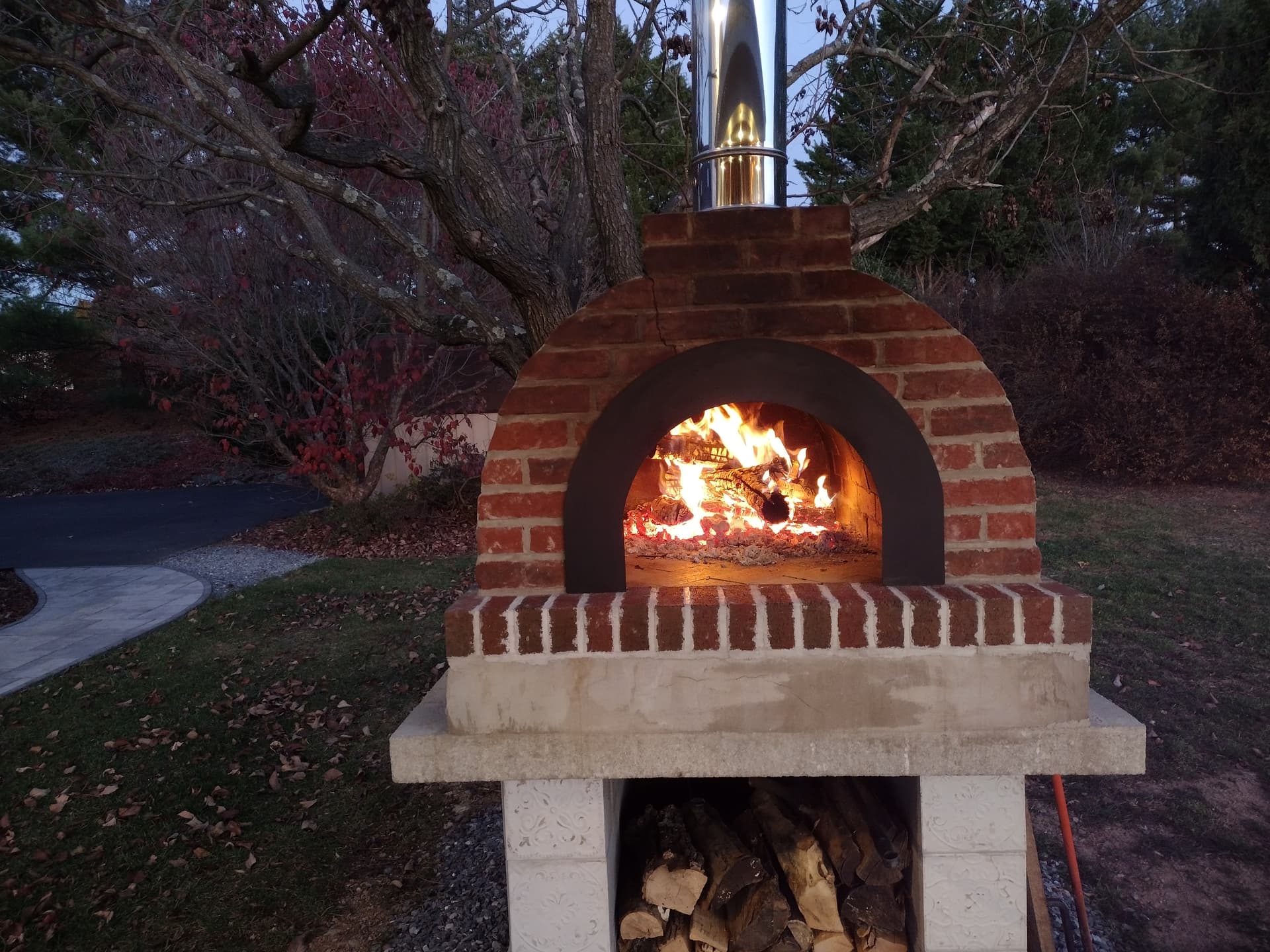

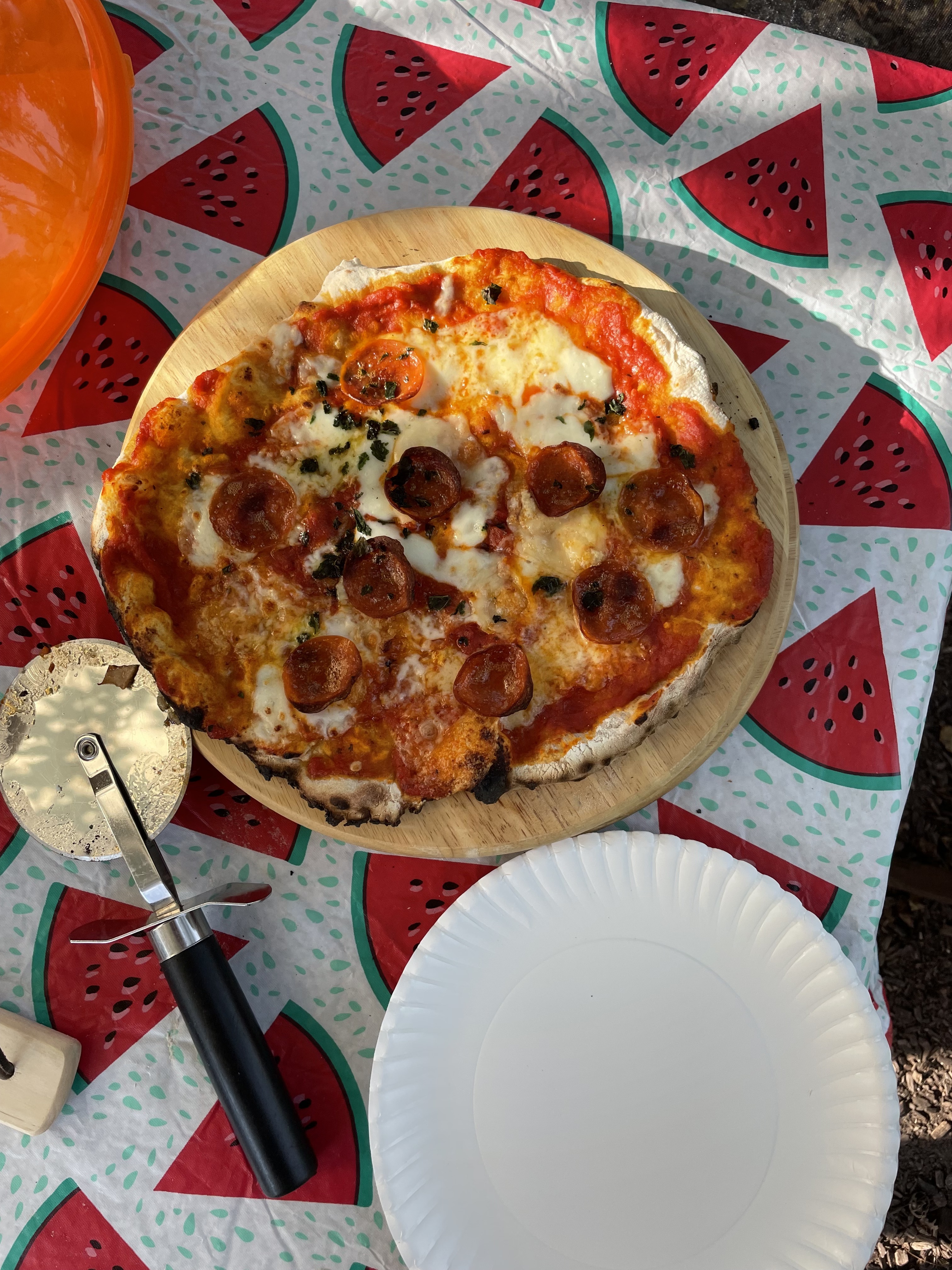

I posted these pictures on the Pizza Reddit forum:
I explained that my biggest challenge when making pizzas is that if I turn the pizza too soon the center tears, too late and the crust burns black. The majority of responses say that the fire and ember pile is way too much and the pizza should be farther back from the flames. Another suggestion was to make the fire along the side of the oven so the pizza can be placed at the back of the oven and thus make the side of the pizza facing the oven visible so I can watch it for burning. I’d like to get feedback from actual MBG users.

The commenters are maybe half right. That pie looks like it’s right next to the embers, so the edges are going to burn for sure.
But I think they’re also half wrong. That’s not too much flame for this particular design, which is different than the dome style many of them may be familiar with.
The keys are:
  • Hot hearth (> 700°F and 800°F isn’t too much)
  • Flames licking over the roof of the arch, offering a broiling effect to the top and center of the pie
I’ve tried it both ways, and I prefer back of the oven as you have it built here. The leading edge of the pie should be no more than halfway into the oven, and you absolutely need to keep an eye on it at all times. The moment the edge starts smoking you need to use that banjo tool to rotate the pie a quarter turn.
There are definitely uses for laying your fire to the side, especially if you are roasting or baking. And some prefer doing pizza that way as well.
Hope this helps, and I know there are other opinions on this, so let’s hear it!
I knew posting here would provide the specific help that I need. I am planning another pizza night this Thursday, I will be sure to keep the leading edge at the half-way point and watch it the whole time. My reason for putting it so close was to be sure the bricks were 750 degrees or so. If I place the leading edge at the half-way point should I build the fire there too so the bricks reach that temperature and then push it back before the first pizza?
As always, thank you @bikerbudmatt!
Good point. In general lay your wood in the front of the oven, and then gradually move it back as the oven heats up. This will get your hearth heated up gradually but thoroughly.
The secondary reason for encouraging flames over the hearth is to keep it heated so you’re baking top and bottom of the pizza at the same time.

Here is what to do
Rule 1 listen to bikerbudd Matt. He know his blank
Rule 2. Build the fire front back
Saturate the back right with coals
Move the fire from center to left corner
Rake the coal bed center to left
After about an hour that floor should be about
750. Clean the soot f the area in which you are going to make the pizza. Like Matt said
Get that flame massive and rolling over the center barrel area of the oven. Stretch the pizza and toss it in. What I do if the flame isn’t quit rolling enough
Soon as you stretch the pie and before you top it
Throw a piece of kindling on the fire to beef it up
Keep the pie 4” away from coal bed rotate as needed. See cooking left to right enables you to see the pie rather than front to back
All very good advice, but your dough might be part of the problem. These high heat ovens like a lower hydration level and strong glutens so that the pizza cooks fast and doesn’t tear.
I like a hydration level of 65-68% though have had success in the ranges from 62-70%. Above 70% and the dough gets pretty soft and sticky BUT does puff up really nice. Looking at the size of the air bubbles in your picture it does look like your hydration is pretty high.
To develop the glutens you need a higher protein flour and you must knead and rest it long enough for the glutens to form. I’ll knead for 5-6 minuets, rest the dough for 15 minuets and knead it again.
Keep at it. You’re really close to having some good pies. (If you would just take the mushrooms off-But that’s just me) :slight_smile:
Thanks very much @kgondoly. I am using 65% hydration and King Arthur 00 flour. I am using a Kitchen Aid stand mixer to knead the dough and I let it rest for 20 minutes after shaping the big dough ball to allow the gluten to develop, then do a 48 hour cold ferment.
As @bikerbudmatt said, I have the pizza too close to the fire, and I think this forces me to turn it before the bottom has baked enough. I am going to make pizza this Thursday and will launch the pizza farther from the fire. I’ll follow up with my results on this thread.

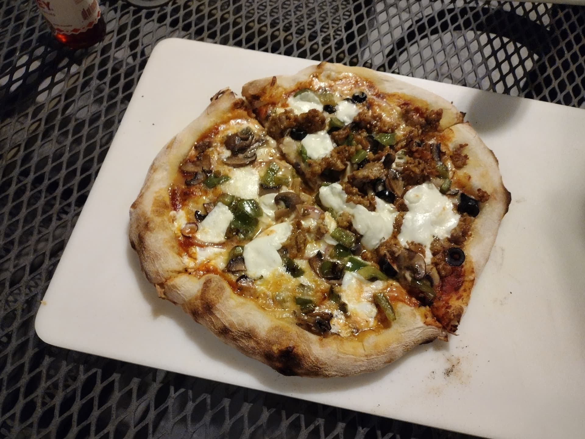

@bikerbudmatt your suggestions were spot on, I finally got an even bake and didn’t incinerate the crust :pizza::fire:
Half veggie, half veggie and sausage.
My pizza journey continues, thanks Matt. :slightly_smiling_face:

It seems like you are doing everything right from the dough, the oven temperature and the cooking aspects.
The one thing I might suggest, based on the pictures, is to go lighter with the toppings. Too heavy and you trap steam from the sauce causing a soggy middle that tears easier. Bill’s photos show a good amount of toppings for this style of pizza. As an experiment try going light sauce and toppings. If you can’t see sauce poking through the toppings you’ve gone too heavy.

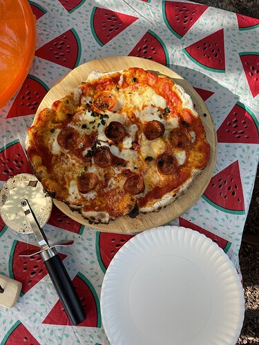

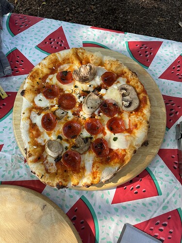

One of my better efforts:
