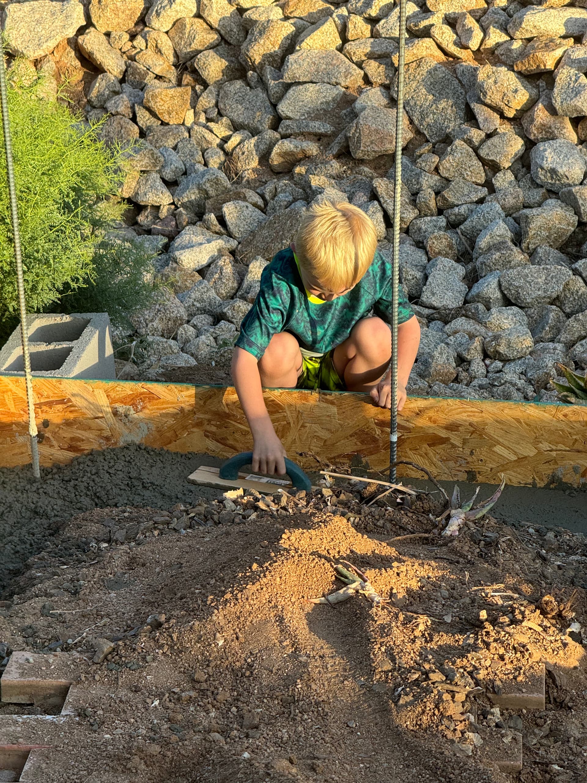

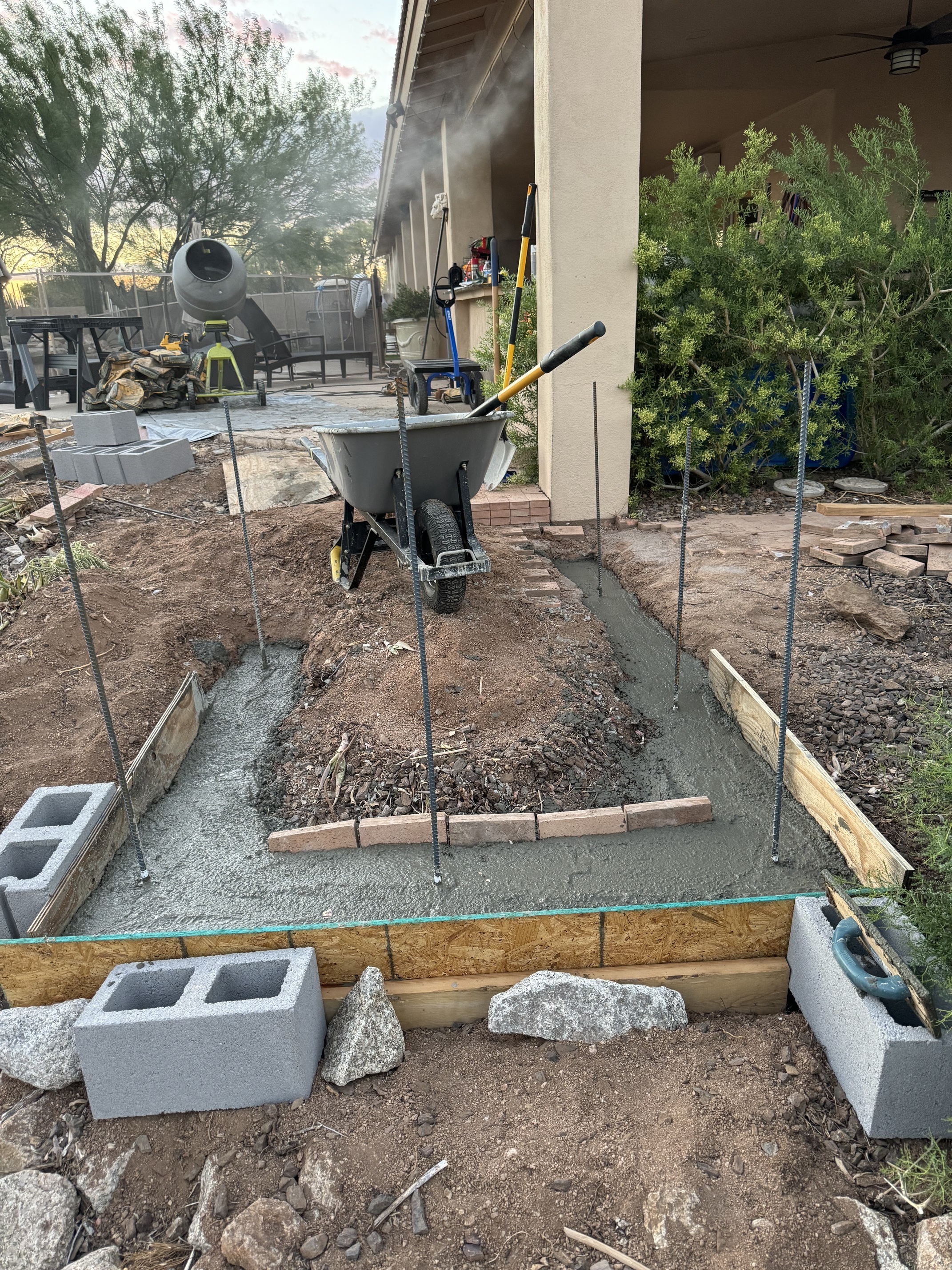

Just finally started our build today! Parts are on order for the grande and will be here this week. My son and I are having a lot of fun already. So far we have only got the footers in to build some block retaining wall before we pour the slabs but it’s going to be amazing!!

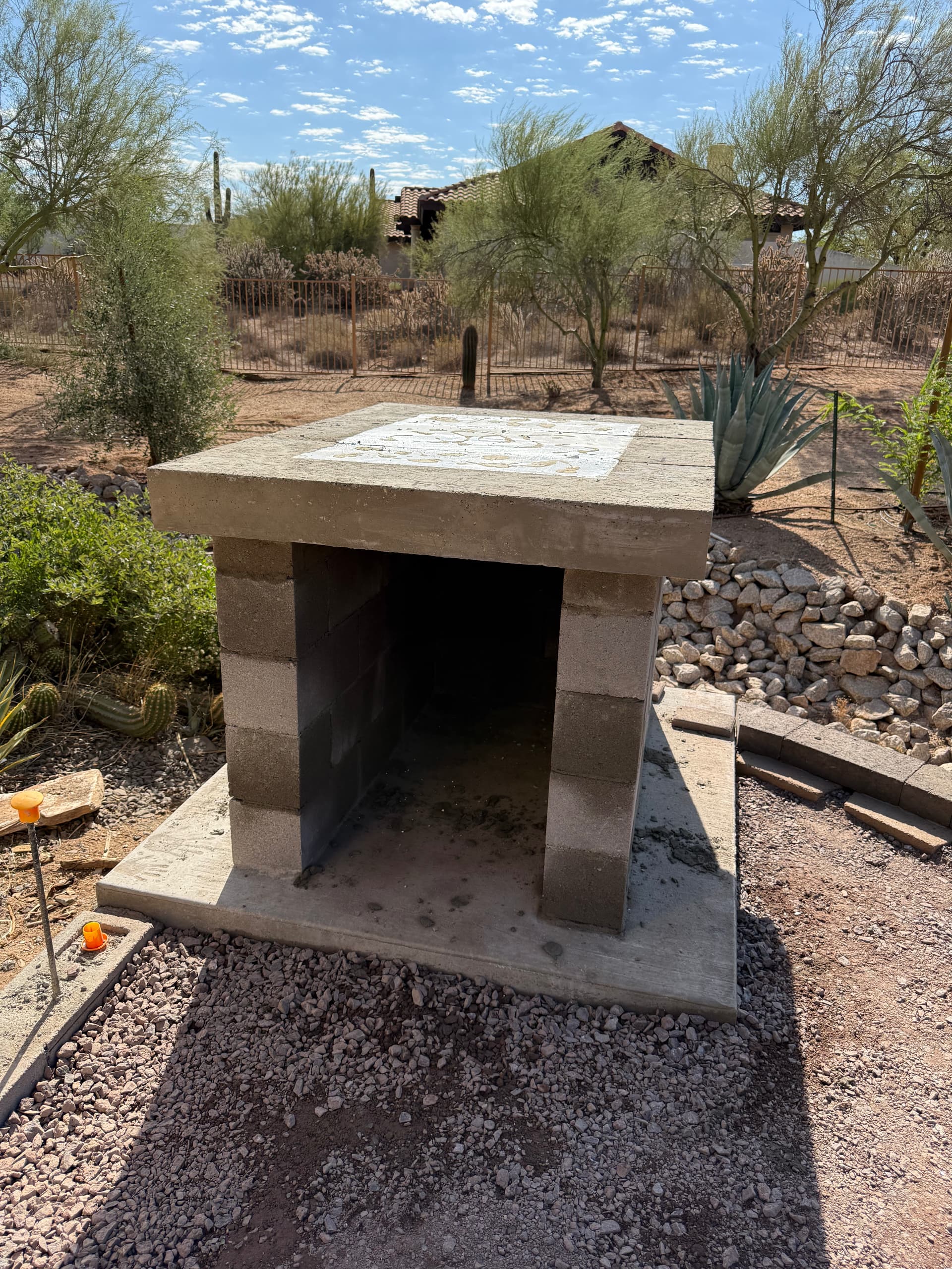

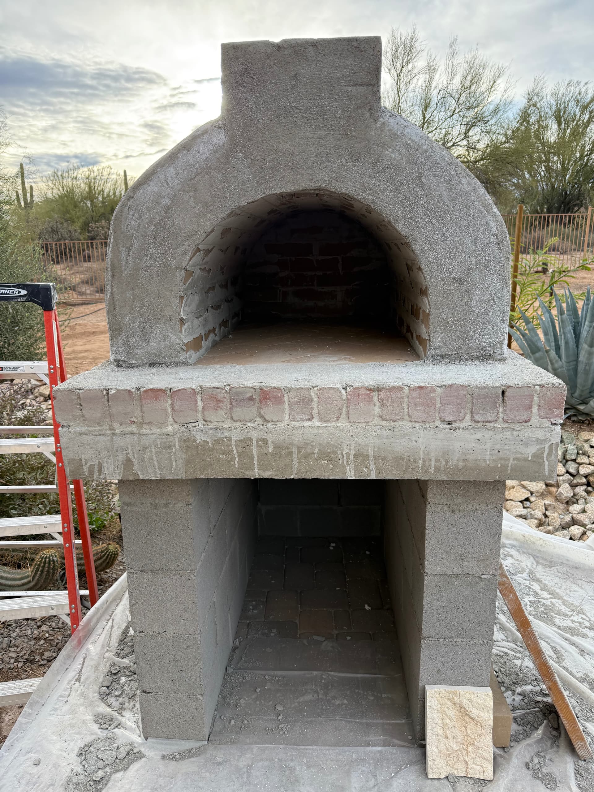

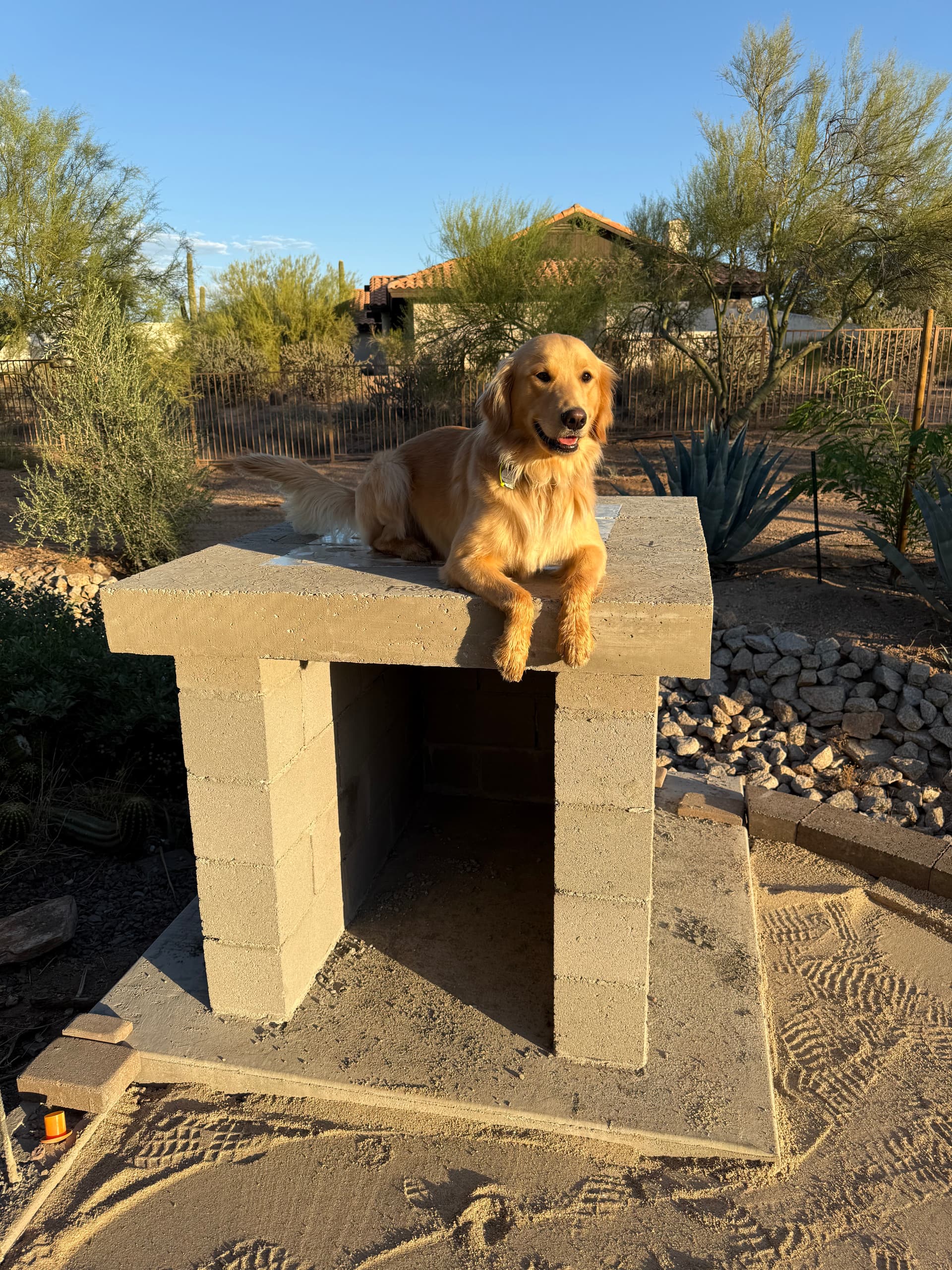

Just thought I would send an update. Since we have been tying in a lot of other remodel around the area we are placing the oven, things have been going slower but progressing! Just got the top base put on and it’s looking great I think. Sure have enjoyed the forum and all the help provided. Also the instructions have been spot on! Very impressed so far. We have all the rest of the material so the next steps are filling the 2" void and then once that cures we can keep moving on! My son enjoyed cutting the foam out as well!

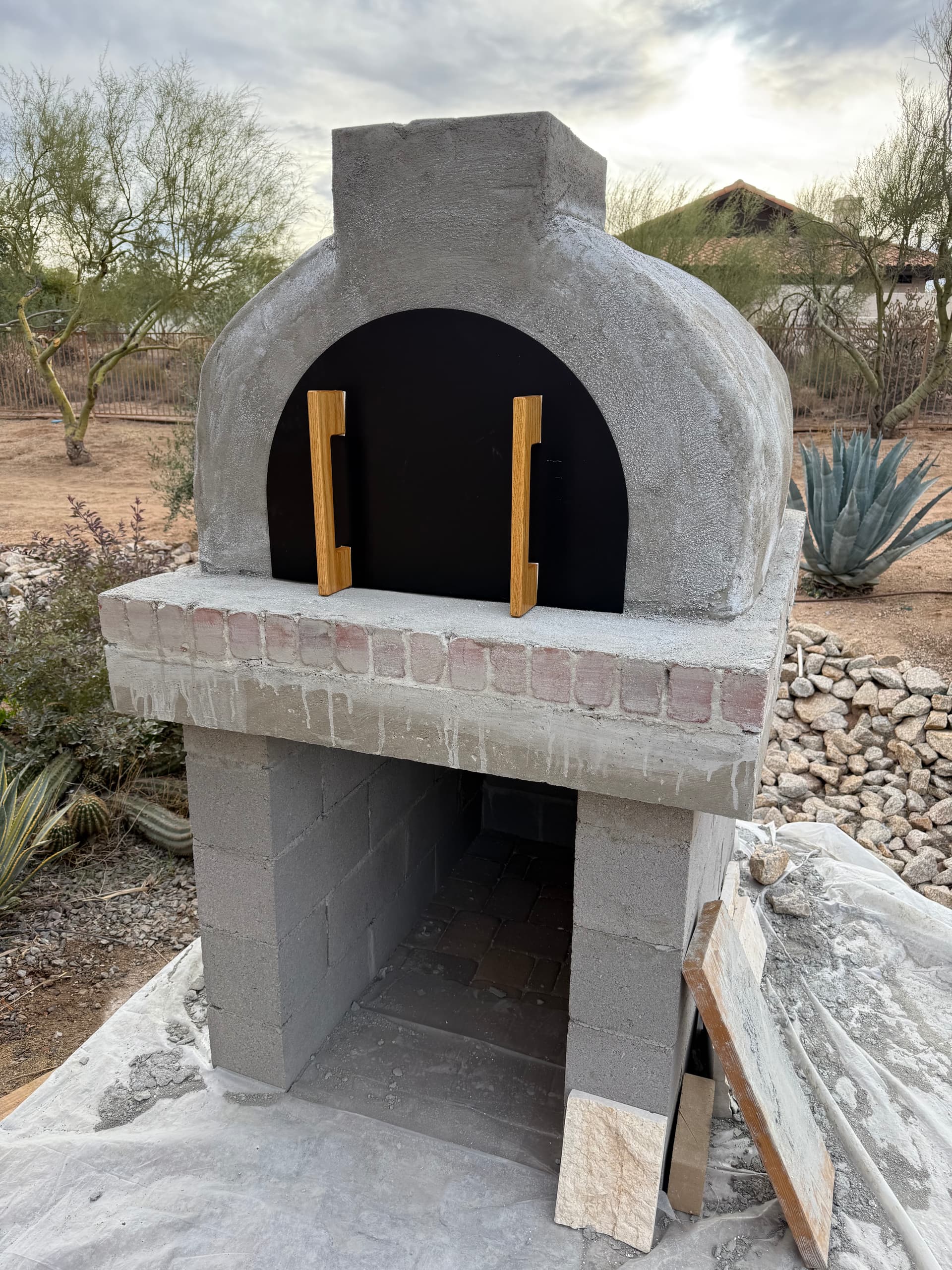

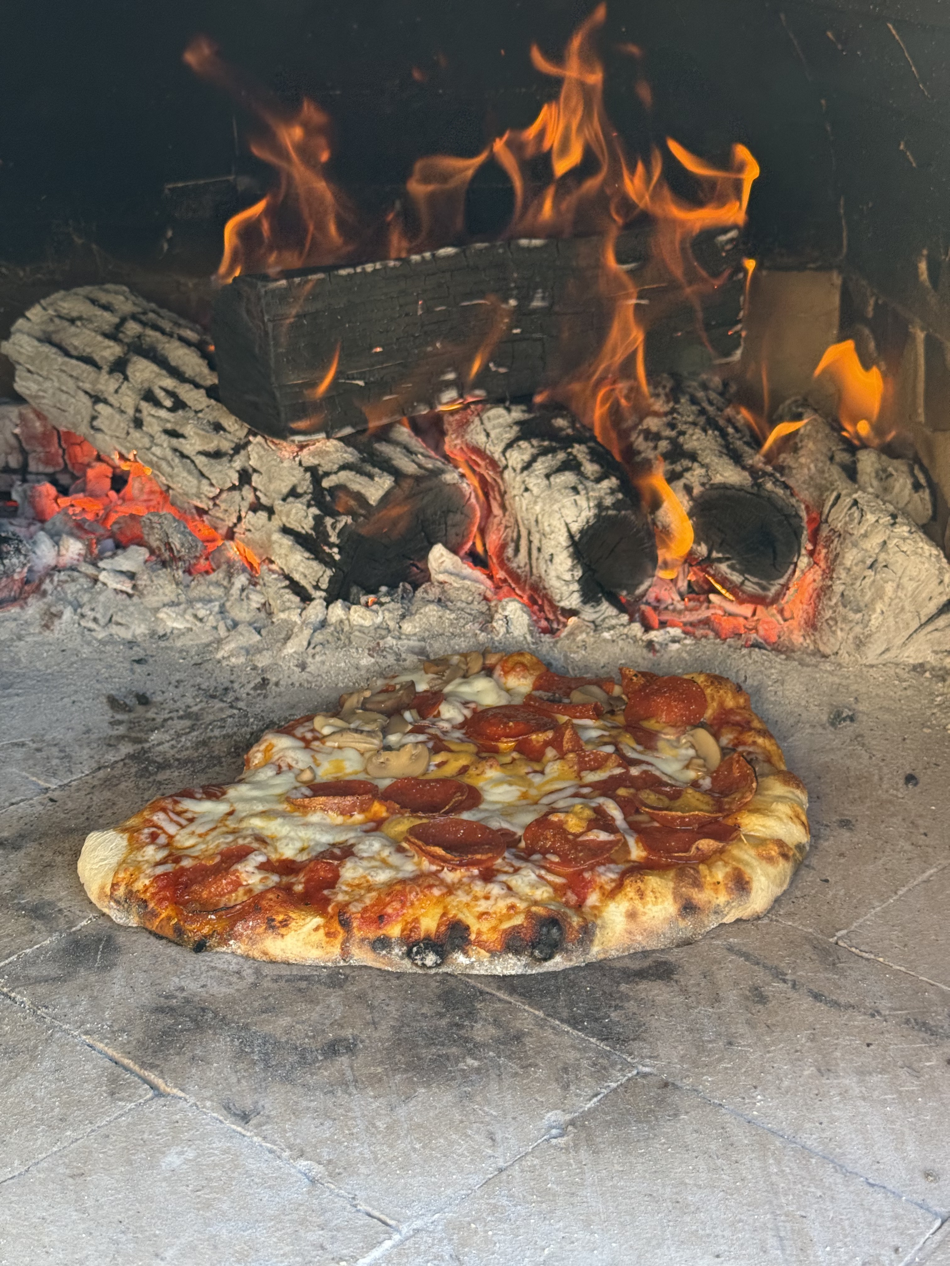

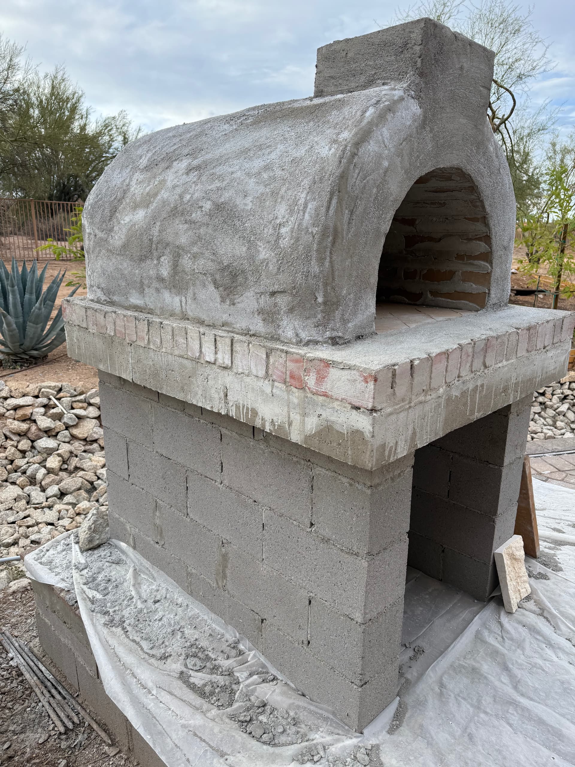

Finally have been able to get this thing to the point of doing our first cure burn in the next day or two. It’s taken some time to get there as I have had a thousand other projects going at the same time. We have some stone veneer on order to put on the base and possibly the top yet but at least we could start cooking. The amount of help on the forums has been so great and I am very thankful for it.

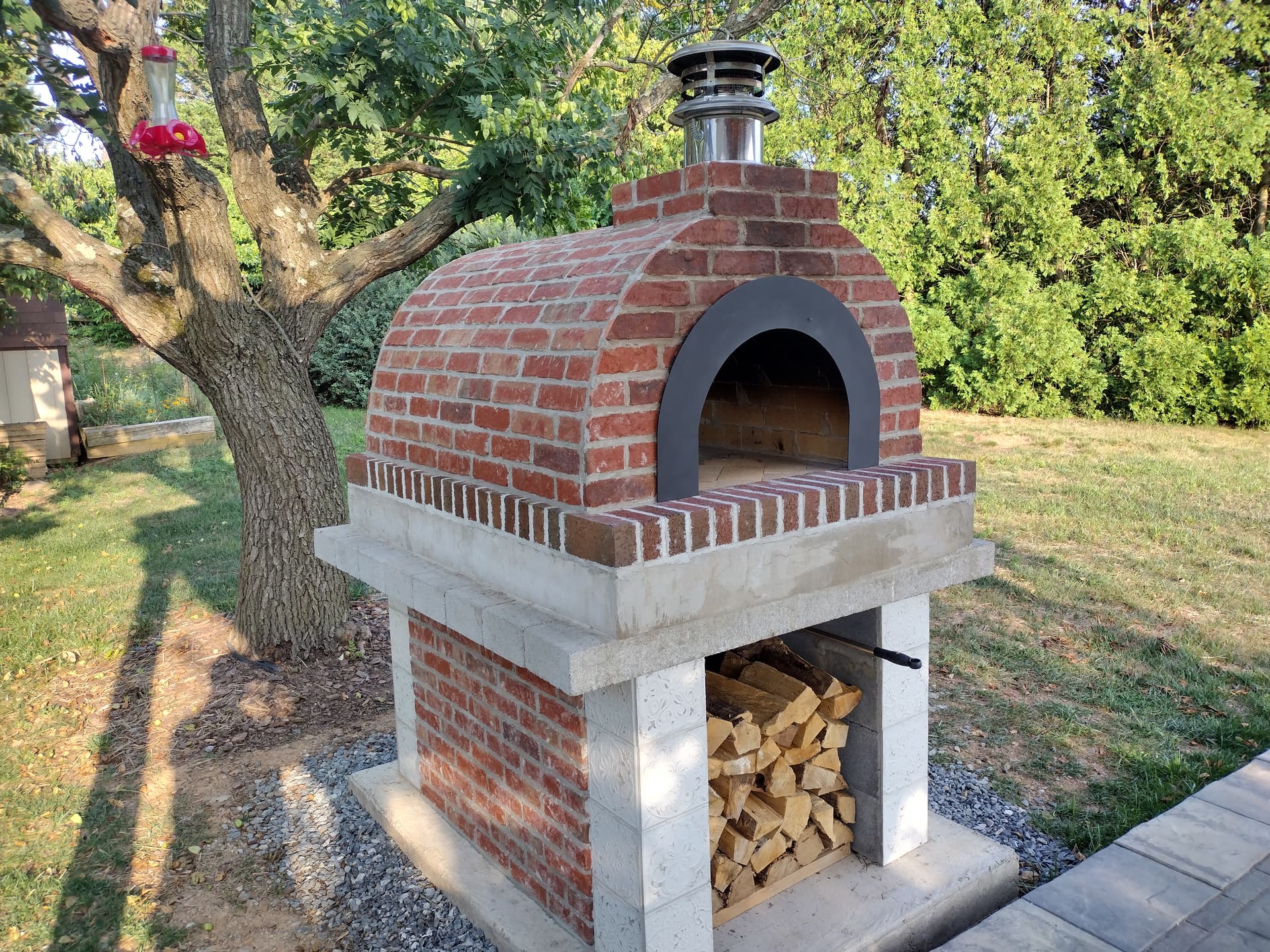

I used brick veneer for my oven exterior then sealed it with a masonry sealer. Until you apply the stone veneer you’ll want to keep the rain off your oven with a sheet of plastic or tarp. If you use your oven before applying the veneer, you’ll also need to take care to clean any soot off the face / sides of the oven and ensure it’s totally dry before you apply the veneer.
One other thing to share. After I completed the curing fires, I got carried away and made a big fire too quickly and too close to the front of the oven, it resulted in the one and only crack on my oven. Always start small to bring the oven temperature up and drive any moisture out and allow the oven to expand slowly. I usually do a two hour heat up before baking my first pizza, floor temperature is around 750 degrees Fahrenheit.
That’s a great oven you have there. Thank you for the advice. One thing we have going for us is we live in the Phoenix area so we do not get much if any rain. We plan on getting the veneer done in the next few weeks as long as I can get it…that all depends on if my wife picks one that’s in stock or not!
Thanks! Looking forward to seeing the finished exterior of your oven. I used Sakrete Stone Veneer mortar when I applied my veneer, easy to work with and strong adhesion. Be sure to moisten the veneer before applying it so that it doesn’t pull the moisture out of the mortar. My oven has gone through many freeze / thaw cycles and I’ve had no issues with the veneer.

Congratulations on the start of your pizza journey @Gulfstream5! Good looking pizza. If you are interested in making Neapolitan style pizzas (the high heat of the wood fired oven is perfect for that style), checkout YouTube Vito Iacopelli’s videos, entertaining and very informative. Please share some pictures once you have it all finished!
